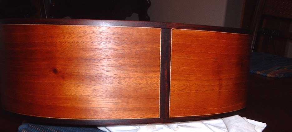

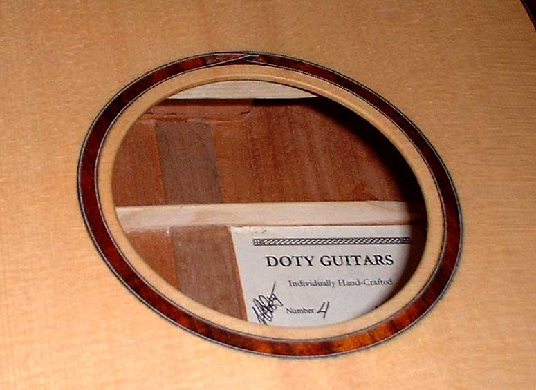

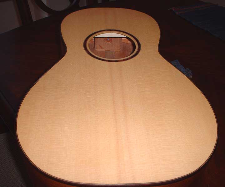

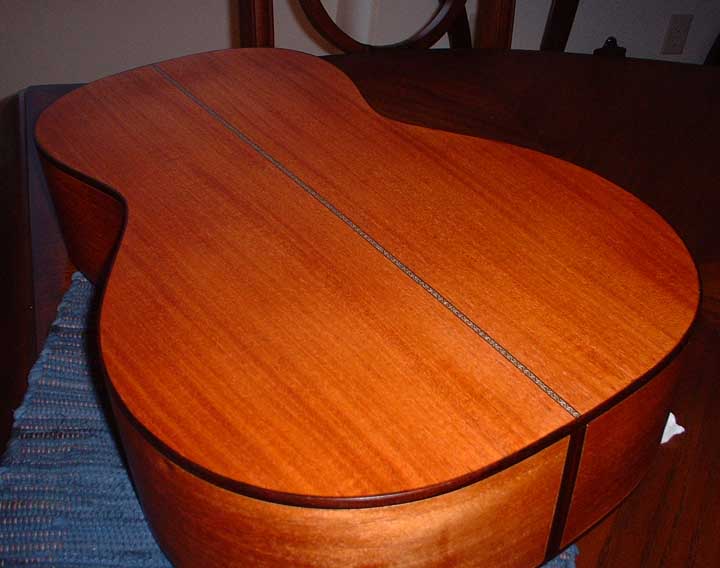

Thanks Colin for the inspiration!
Based off of a Martin 1-18 plan, parlor size, bolt on neck.
Cuban mahogany back and sides, englemann top, rosewood binding, and zig zag back strip, koa rosette. It will have a mahogany neck that I found on ebay that should be here soon. This is my 1st mahogany guitar.
I am finishing it with Tried and True varnish oil. And, I really like what I see so far. For those of us who can not afford to pay for every guitar to be professionally finished, or have an area where we can deal with dangerous finishes, this is a great alternative. No toxic fumes, hand applied, and a semi-gloss finish after several coats, and some elbow grease. I have a few more coats to go, so it will have a better luster than what is shown.
Jeff

I sanded to 220, put down 3 coats of the Tried and True Danish oil, lightly sanding with 0000 steel wool between coats, and have also added 2 coats of the Tried and True Varnish oil, also sanding with the 0000 steel wool lightly.
I did not pore fill on this guitar as I had never used this finishing product. Open pores do not bother me, and seem to be fairly small on this Cuban mahogany, or at least small enough to not be detracting.
I don't think there would be any problem using the Robbie O'Brien end grain sawdust and shellac method of pore filling, and then using the varnish. Not sure if zpoxy finishing resin would work or not. I just want to test those before I tried it on a completed guitar.
The directions on the can say that the more you rub out the finish with each coat, the more luster and gloss you     will get. So I am going to go with a few more coats, and then rub the heck out of it to see what kind of gloss I can get.
Jeff

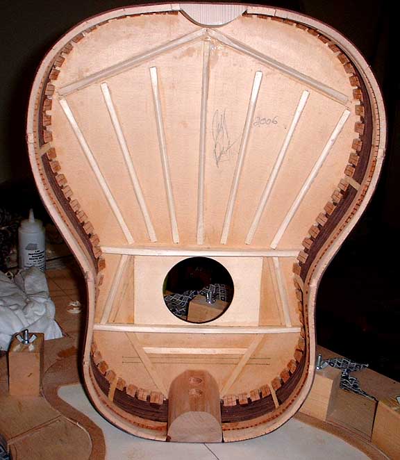

My next project is pictured below, a classical, EIR, englemann, with a bolt on neck (which should get me promptly tossed on a burning pile of tentelones for not using the Spanish heel/foot!)
Thanks again.
Jeff
PostPosted: Thu Jun 08, 2006 3:40 pm
Posts: 1051
Some very famous Classical builders are starting to use bolt-on necks...true it is not true Spanish construction but it works. Thomas Humphrey gets 10K per guitar and he uses bolt-on necks as does William Cumpiano...coincidentally both of them started by working for Michael Gurian in New York City. Tom did mostly batches of classicals while Cumpiano did mostly steel string.
I do not personally use a bolt on neck although for a steel string it is a very compelling joint, especially if a tenon is also used.
I use a spanish foot but instead of slotting the neck block as is traditional, I have switched to the tapered wedges that Romanillos developed. The result is the same type of Spanish foot but with the ability to easily repair the neck at some point in the future. It makes alot of sense and because alot of classical builders have attended Romanillos' workshop, they have adopted it into their own construction. I believe that Joshua French also uses that type of neck joint.
The classical looks good...dont be afraid to brace lightly and go thinner with the top then you would for a steel string.
